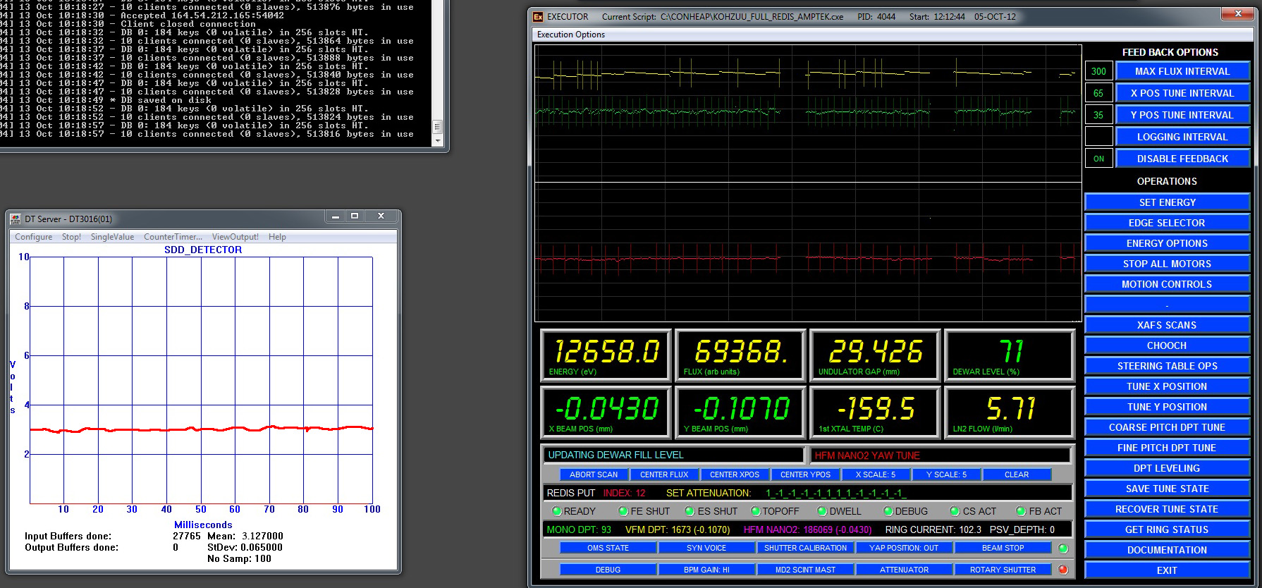

Third, the flux of the beam should be optimized at the peak energy (or slightly above it) so that the fluorescent scattering from the crystal is not overloading the "SDD DETECTOR" (on rightmost monitor- top left corner of figure 13). Change the flux to 1%. Open the shutter (click on toggle shutter in the lower portion of menu) and watch the counts appear in the "DT SERVER". You want make sure that the counts are in the range of 1-6 units, by adjusting the transmission. Optimal counts are around 3-5 as shown in the Figure 13 below. Adjust the flux, if necessary.
Figure 13. The view of the right most monitor of the beamline computer, illustrating proper flux for EXAFS
