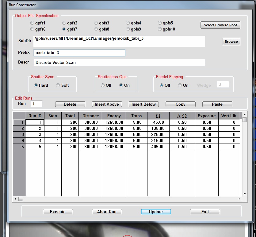

When you are going to "data collection"  mode and select "run constructor" the following dialog will appear:
"Shutter Sync" should be always "Hard"
"Shutterless Ops" should be "ON", unless you want slowly collect data.
It is recommended to use "discreet vector scan" to collect data along long crystal  and use
shutterless mode.
