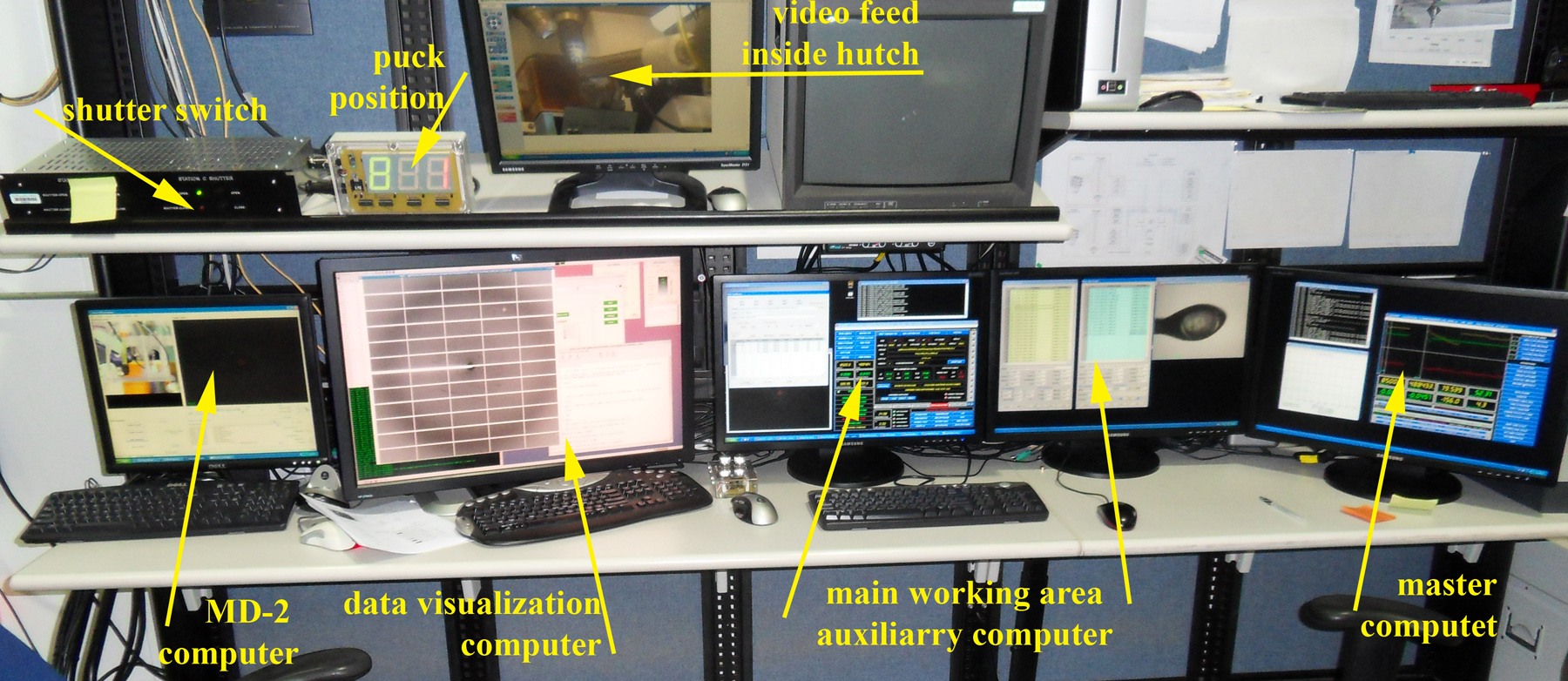

1. General Computer Layout
Our computer network can be roughly separated into five parts: (1) ADSC data collection computers, (2) MD2 operation computer, (3) two computers for the beamline control, (4) three computers for data processing and structure solution and (5) data storage and backup. You should use computers in category (1), (2) or (3) ONLY for data collection and the beamline controls (no Web browsing, games, music etc). In addition, there are two more shared computers in the back user area.
Figure 1, General view of the
main working area on 24 ID-C.

Beamline Control Computers The beamline
control software runs on two different Windows computers, namely
"master" and "auxiliary". The video
from these computers is output to 3 rightmost LCD monitors (see
picture above). You can switch between these computers by pressing
<ctrl>
button twice. All user operations are done on "auxiliary"
computer only.![]()
