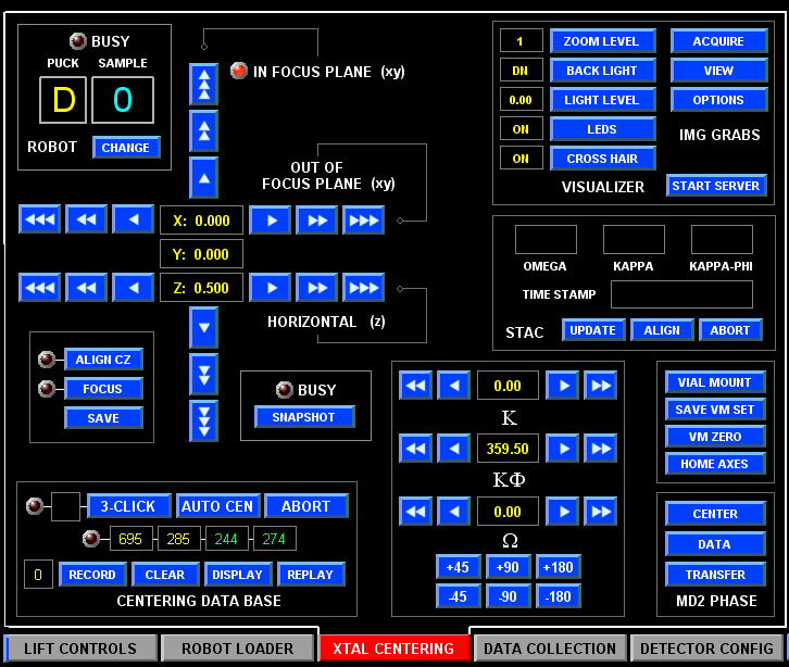

XTAL CENTERING is the extension of the centering mode of MD2 software for use with mini-kappa goniometer and several robot manipulation tasks.
Figure 6. General view of "XTAL CENTERING" tab
There are several embedded operations in this window (from left top corner clockwise):
1. Robot puck ID number (current) and the button to mount next crystal - "CHANGE"; when "BUSY' light is on - the robot is busy doing something, wait before clicking. You can also dismount a currently mounted crystal or wash it.
2. Section to control camera zoom, lighting of the crystal, and ability to acquire or view your crystal picture. StartServer button should be used only if the separate visual window is not started automatically.
3. Controls to manually adjust Kappa/Phi/Omega for mini-kappa; if using single-axis goniometer-only omega should be used; predefined crystal rotations to check the alignment. Users are advised not to change kappa angle more than 40 degrees in one step, as the crystal may go out of the cold stream.
4. The function to acquire STAC strategy parameters from RAPD for better crystal alignment (i.e long axis close to omega rotation axis) and align the center of the crystal at new kappa/phi. Make sure you are using the correct values and the most recent ones (check timestamp).
5. Three button to change MD2 mode: Center(default), Data collection and Sample Transfer
6. Buttons for crystals rotation and input field for a specific phi-angle, including vial mount.
7. 3-CLICK alignment tools, including alignment for crystal rastering: First, CLEAR the database, second do 3-CLICK at the beginning of the raster vector, press RECORD; third, repeat 3-CLICK centering at the end of the rastering vector, and press again RECORD, it should be number 2 in the left box. DISPLAY will show consequently the beginning and the end of the raster vector and REPLAY will repeat two alignment processes. More than two points may be created for complex cases. 3-click alignment should be completely finished, before proceeding to the next operation. ABORT may be used to leave the "3-click" function.
8. Snapshot button to collect snapshots – a snap constructor dialog will appear - (no need to go to different tab)
9. Buttons for manual movements of the crystal: vertical, horizontal and along the beam (out-focus plane). 1, 10 or 50 microns increments.

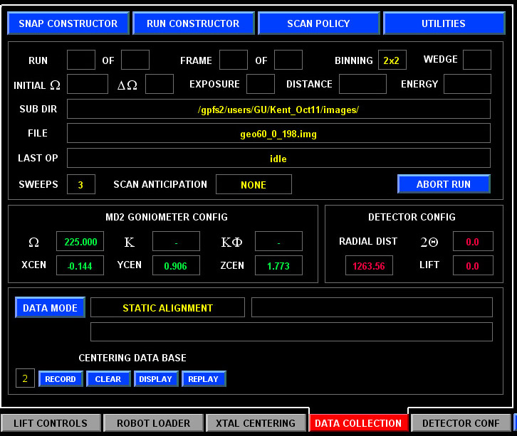

DATA COLLECTION tab is used to control ADSC snapshot/data collection parameters.
Figure 7. General view of "DATA COLLECTION" tab

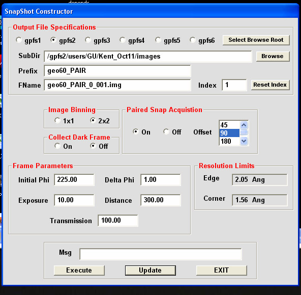

SNAP CONSTRUCTOR button opens the following dialog window:
Here you choose all parameters for snapshots. First, you need to define the root directory for your data collection (unless that was not done earlier) - by clicking on "Select Browse Root". It should be the images sub-directory below the directory assigned to your group. Next click on "Browse" button and select, or create a new directory, for current project. Confirm by clicking “Update”. Next type the file prefix in the corresponding field. Click "Reset Index", if necessary. Select binning mode (1x1 or 2x2) and "Pair Snap Acquisition". When "Paired Snap Acquisition" is ON, two images separated by chosen offset value are collected, and LABELIT/RAPD will autoindex them together with much higher success. Type in Initial phi, oscillarion range, exposure time, detector distance and transmission. Click "Update". Resolution Limits are updated once detector distance is defined and UPDATE is pressed.  EXECUTE leads to collection of defined snapshot(s). EXIT closes the dialog window and return operations to DATA COLLECTION tab window.
Note: It's VERY important to click "Update" on this window and similar ones for data collection; otherwise previously collected image(s) may be overwritten.

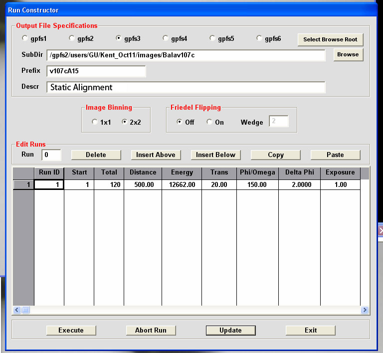

2. RUN CONSTRUCTOR - the following dialogs opens, depending on what is selected when DATA MODE was pressed:
Here you choose all parameters for standart data collection: Every field can be manually edited, as necessary.  First, you need to define the root directory for your data collection (unless that was not done earlier) - by clicking on "Select Browse Root". It should be the images sub-directory below the directory assigned to your group. Next click on "Browse" button and select, or create a new directory, for current project. Next type the file prefix in the corresponding field. Select binning mode (1x1 or 2x2), and "Friedel Flipping" and corresponding wedge size. Type in Run ID, Number of frames, Detector distance, Initial phi, Oscillarion range, Exposure time,  and Transmission. Repeat for another run , if necessary. Once all values are checked, press "Update" and "Execute".  EXECUTE leads to collection of defined run. EXI close the dialog window and return operations to DATA COLLECTION tab window.
ADSC data collection can be aborted by pressing "ABORT RUN" button in the middle right area.

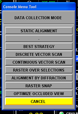

More complicated scenarios are defined when pressing
"DATA MODE" button - see menu at right -->
2B. STATIC ALIGNMENT – described above
2C. BEST STRATEGY - under development.

In the "Run Constructor" dialog window you should setup subdirectory for data collection and file prefix (see above), check the correctness of all runs. If there is any mistake, Click "Exit" and go back to "DATA MODE" and make all changes in the "DISCRETE VECTOR SCAN" dialog. If all runs are correct and all values are checked, press "Update" and "Execute".  EXECUTE leads to collection of several defined runs along your crystal. EXIT closes the dialog window and return operations to DATA COLLECTION tab window.

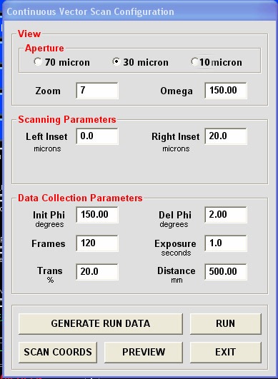

2E. CONTINUOUS VECTOR SCAN –(sometimes called helical scan) – more advanced mode as compared with "DISCRETE VECTOR SCAN" - continuous data collection all over the predefined raster vector. In this mode the crystal is translated/rotated after EVERY image collected to better spread the radiation decay. This mode is nearly two times slower as compared to "DISCRETE VECTOR SCAN" mode. The following dialog window will appear where you choose the aperture size, zoom view  and omega angle for visualization.
LeftInset and RightInset are offsets from predefined raster vector ends (not zeros - if you want to collect data on a shorted portion of the crystal). They may be negative if you want to extend data collection beyond predefined vector.
Next setup data collection parameters based on the calculated strategy by RAPD.
Pressing "GENERATE RUN DATA" will open a data collection dialog and in a graphics window on the left you may monitor relative positions of every image point along the raster vector, with all data collection point simulated in red.
Pressing “RUN” will open ADSC data collection dialog which show only one run and it should not be edited (except run number and directory name). Just press "Update" and "Execute" for data collection.

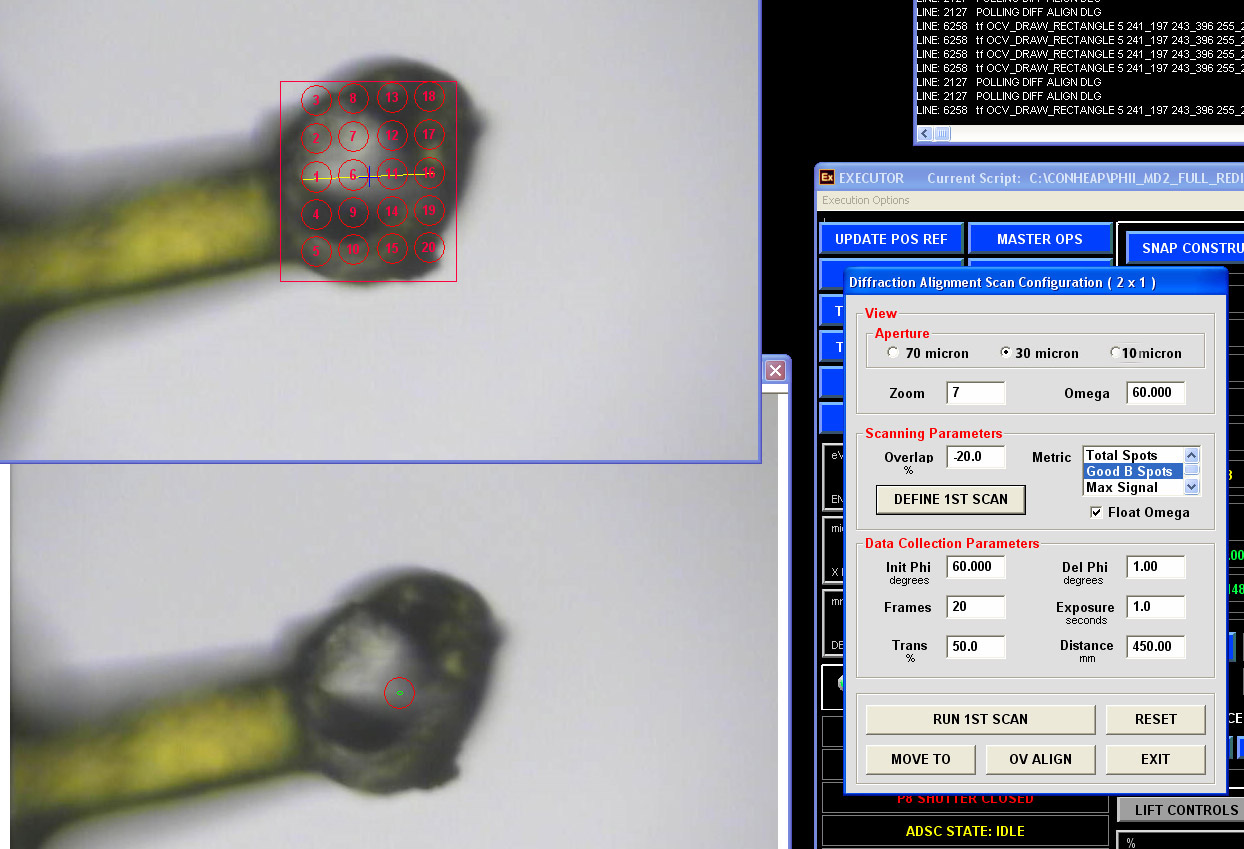

2F ALIGNMENT BY DIFFRACTION - is used to find your crystal in an opaque/non-clear loop: the loop is rastered by a very weak beam and the software analyzes all collected images to find one with the better and stronger diffraction. In the following dialog window you select the necessary parameters:
It is recommended to use 70 micron aperture for big loop and use Omega value corresponding to plane of the loop. The "Metric" parameters are used by DISTIL to recognize best diffraction: "Good B Spots" is the best choice for now. "Overlap" defines the overlap between different search points: use a negative number for a sparse search.
Press "DEFINE 1ST SCAN" and a new window will appear in the top left side, use the left mouse to define a rectangular search box. The final search area will be automatically defined as a convolution of your search box and image centering server oval covering the loop.
Change transmission value to 1% or less and define the desired detector distance. Exposure and DelPhi should be 1 second and 1 degree. Press "RUN 1ST SCAN"; the system will move the loop through all red circles/ellipses and store the corresponding coordinates. After that on ADSC computer the diffraction images will appear. All images are stored in "/gpfs1/users/necat/phi_dfa_1/in" directory and will be deleted after exiting the ADSC tab. The message will appear when the run is complete.
A table with processed results will appear, on which it is possible to select different points and check again the corresponding diffraction (can be also done by making selection in lower left graphics window). Once the region of the best/strongest diffraction is found, pressing “MOVE TO” will center that portion of the loop for subsequent data collection. Or if it is necessary, you may proceed and scan the orthogonal orientation using the “OCCLUDED VIEW”.
Now you need to repeat the same procedure in the orthogonal orientation:  Press “DEFINE 2nd SCAN” and repeat all steps above. If successful, the loop will be centered on the best "diffracting crystal" position. Click EXIT to close the Diffraction Alignment dialog. Proceed now to the data collection by pressing RUN CONSTRUCTOR
