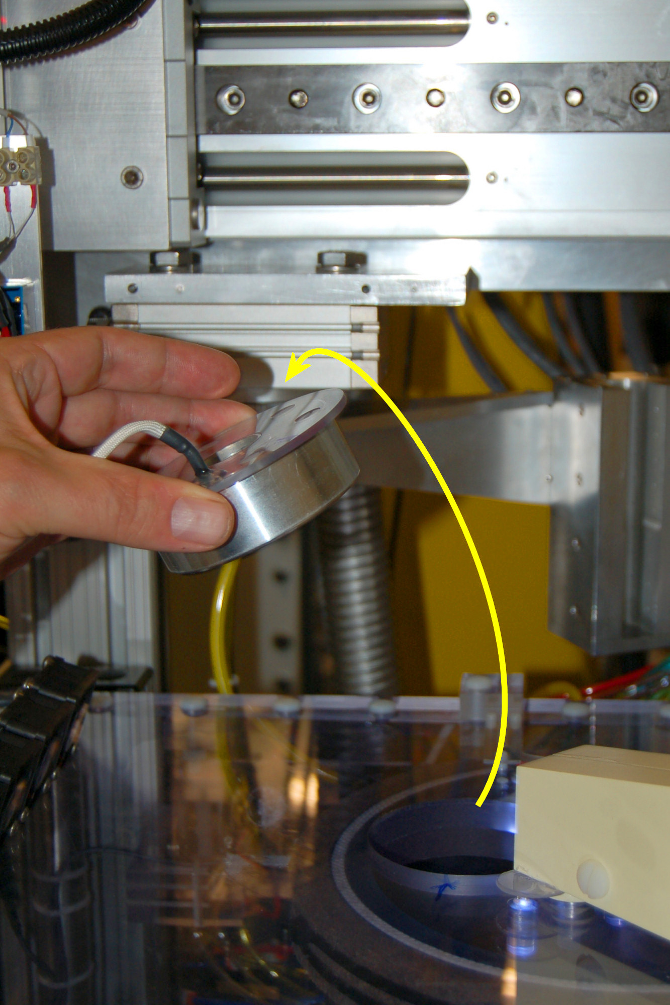

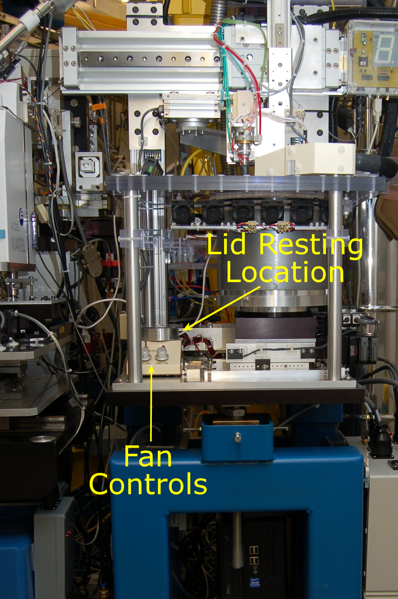

5.  Turn off the fan for better viewing. The switch for the fan is the light-yellow box (left figure). Rotate CCW the “UPPER FAN” dial to turn off the fan. Before pucks can be loaded, the lid must be removed and placed in the lid resting location: see figures below.
6. Remove the puck from the shipping cane. Turn over the puck so that the thick part of the puck is face up. Attach the puck pusher to the puck. Orient the puck so that the notch is facing the center of the dewar. Load your puck into the dewar by lowering into the liquid nitrogen and feeling for engagement of the notch with the pin. It is recommended to slightly tilt the pusher toward the center of the dewar. When the puck is engaged, then it will not move in the dewar and the puck pusher will be perpendicular to the opening of the dewar. The puck will also be seated inside all three pins. Once the puck is engaged, push down with the plunger (of the puck pusher) to separate the two pieces of the puck. Then lift straight up in order to avoid disturbing the pins. Visually check the alighnment of ALL pins, use long (and cooled) forceps to place properly tipped over pins.

8. Once all your pucks are loaded, replace the lid on the dewar (make sure the pin on the dewar is engaged in the lid) and turn the fan back on.

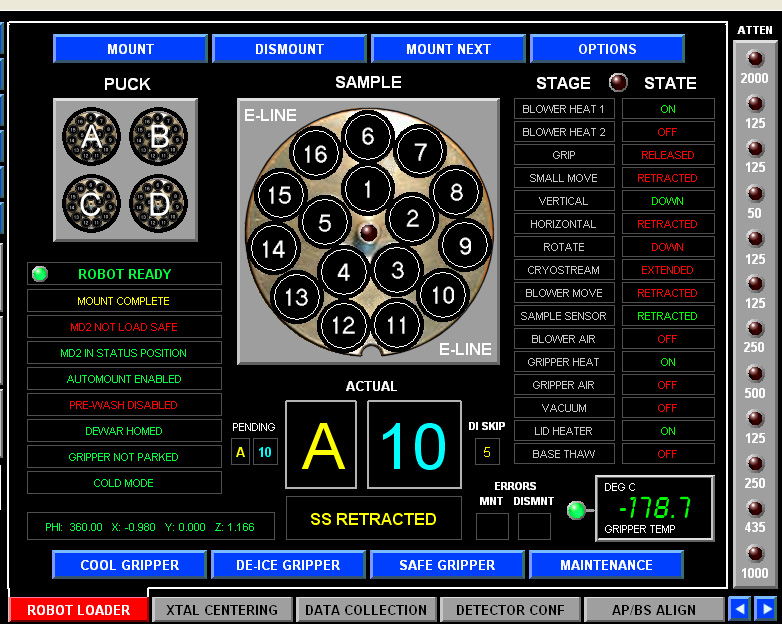

All robot operation can done OUTSIDE the hutch, using either the XTAL CENTERING tab (most used robot functions only) or the full robot script running on auxiliary computer – by press tab “ROBOT LOADER:” You should see the following screen (Figure 5):
Figure 5. “ROBOT LOADER” window for all robot operations

1. You must cool the gripper prior to mounting your first sample. Press “COOL GRIPPER
2. To mount your first sample click the Puck ID (A, B, C or D), then click the Sample ID (#1-16). The Puck ID and Sample ID colors will change to red as the robot moves to the sample location. When the dewar move is complete, the Puck ID color will change to yellow and the Sample ID will change to cyan.
Make sure that the BUSY light is green (not bright red), ROBOT READY and the status is DISMOUNTED
3. Then click MOUNT under Mount Ops.  The robot will start mount the selected crystal;
 Be Patient – it takes ~50 seconds to finish!
When the sample has been mounted, the voice will state, "Ready to Align Sample." At this time, you may align/center your crystal. The robot is still busy doing first de-icing of the gripper and second cooling it. Please do not click anything in the robot window at this time
