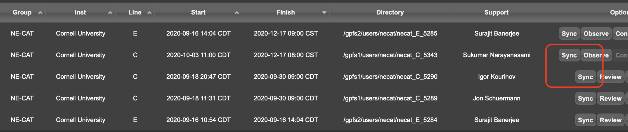

If you collected your data via remote, you can download your data using the sync script. Click 'sync' button next to the session you want to download on the homepage of the NE-CAT Remote GUI. This will download the sync script to your machine.

The sync script that you download expires after 72 hours. If you still need to download data from a session after your download script has expired, simply return to the NE-CAT Remote GUI and download the sync script again, this resets the time limit.
