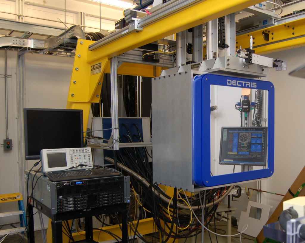

The PILATUS-6MF hangs from the A-frame in C hutch during testing. The control computer for the PILATUS sits on a cart to the left.

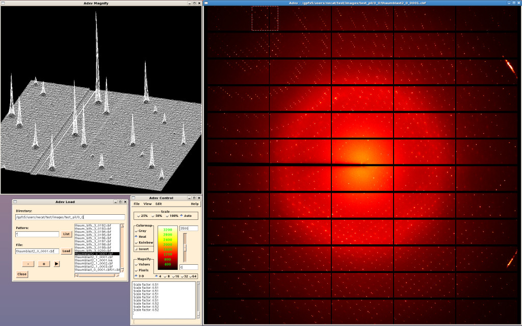

Thaumatin data collection using the PILATUS-6MF
